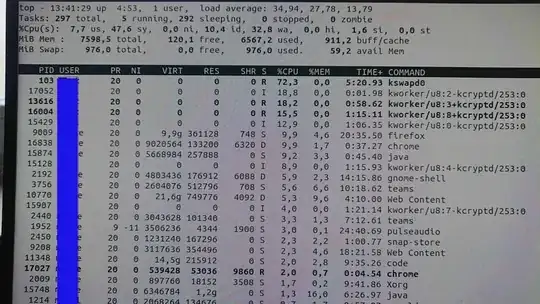

On an almost daily basis my laptop is stuck. In most cases I need to turn off the machine manually and restart it. In those cases CPU is very busy and memory seems to be used heavily.
Memory: 8GB
CPU: Intel(R) Core(TM) i7-7600U CPU @ 2.80GHz
This happens, when I use different apps, like a browser, eclipse and Microsoft Teams, but the combination of running apps seems to be pretty random.
Output of top
~~Now I can see some processes are using very much CPU, but what exactly is kswapd0 and kworker?~~ I guess, that my system is misconfigured, the current guess is that the swapfile is too small. How can this be increased / controlled?
