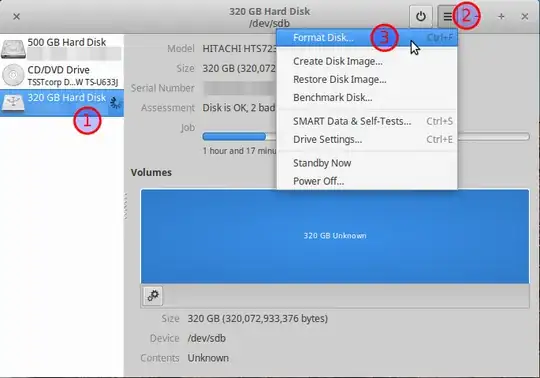

Now, Disks (gnome-disks) tool has ATA Secure Erase. You may use it to erase your hard drive. Same option explained in this answer using the command-line tool hdparm.
WARNING!
Please, review disclaimer and warning notes at https://ata.wiki.kernel.org/index.php/ATA_Secure_Erase (Thanks to @colan to bring this up)
Also comments below. Some hardware may break.
  1. Open Disks tool → Choose the target disk
  2. From menu: Format Disk...
  3. Select from drop box, Erase: ATA Enhanced Secure Erase ( if offered for the drive you selected ). Alternatively you can select Write zeros (slow) which can reasonably be considered to be secure.
  4. Format
