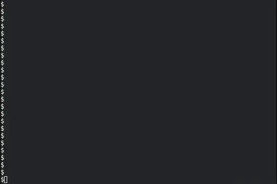

Nwipe, it's a fork of DBAN but unlike DBAN is actively in development. It can run as a command line tool or it's default mode is ncurses GUI. It's in the debian, ubuntu, Fedora repositories. Or if you want to run from a USB stick shredOS, which uses nwipe.
https://github.com/nadenislamarre/shredos/pull/2#event-2855392401
https://github.com/martijnvanbrummelen/nwipeenter image description here
