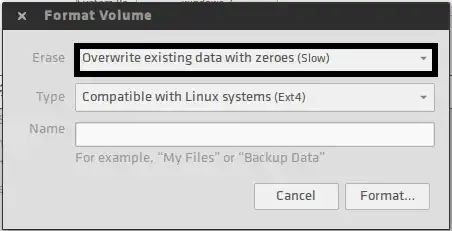

If you want the data on HDD to be unrecoverable then follow this procedure.
You can do it in graphical way also:
  • live boot in Ubuntu
  • launch Disk from dash and delete all partitions
  • then click on format and set Erase to Overwrite existing data with zeroes (Slow). Filesystem can whatever you want
wipe all data
