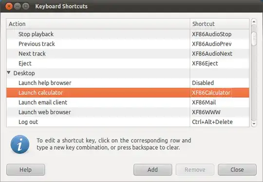

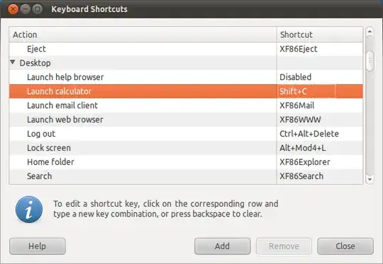

Once you know the key name you can restore it to its default value.
For example, let's say you want to restore the shortcut to launch the calculator,
screenshot
Simply run:
gconftool -u "/apps/gnome_settings_daemon/keybindings/calculator"

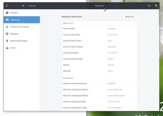

On Ubuntu 17.10 (in the new settings window):
Choose Settings > Devices > Keyboard, then Reset All...
