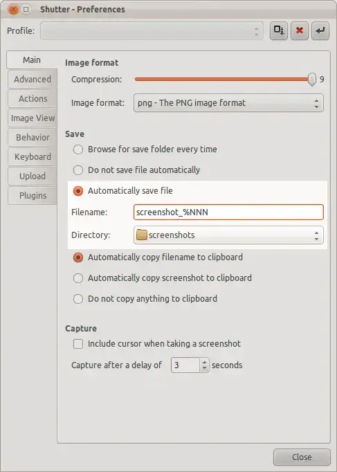

Shutter Install shutter has an option to automatically save screenshots, incrementing the filename each time.
Edit ➜ Preferences ➜ Main ➜ Save :

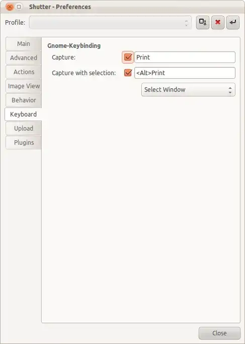

go to Edit ➜ Preferences ➜ Keyboard and check the Capture checkbox:

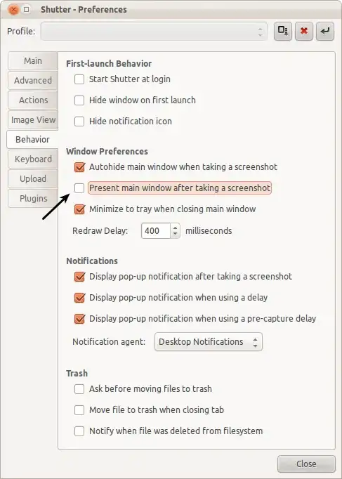

If you don't want the Shutter window to pop up every time you take a screenshot, go to Edit ➜ Preferences ➜ Behavior and uncheck Present main window after taking a screenshot :
