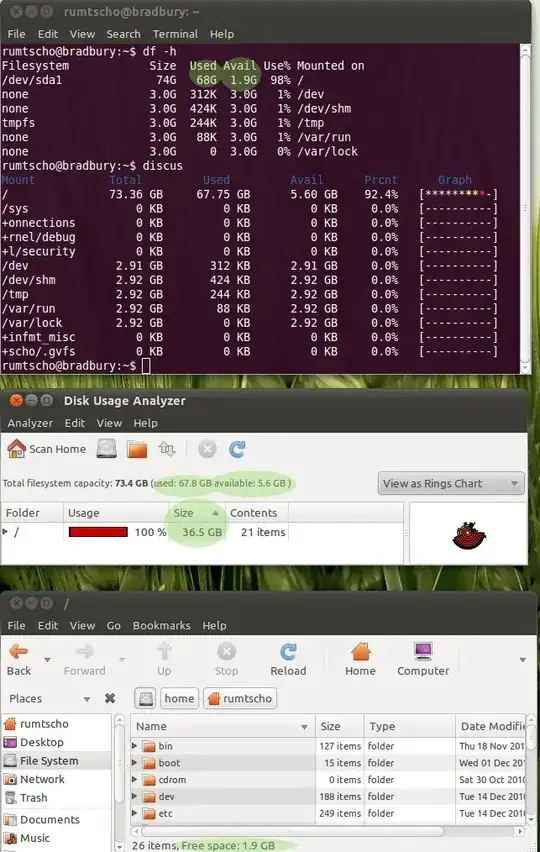

I have only one disk in my computer, a 80 GB SSD. It is formatted as a single ext4 partition (no swap), and all the usual folders are installed on it (I keep lots of data on external media, but /home and all the rest is on the SSD).
Today I booted it and I got a message that the drive is full. I opened Disk Usage Analyzer to look at what takes up space. It insists that 67.8 GB of the disk are used, and that / is taking up 36.4 GB. Which leads to the question, where are the missing 30 GB, if not on the file system?!
Just to have a comparison, I added up all the sizes of all readable folders listed in Nautilus as subfolders of / (including the hidden ones). I got 20.9 GB. Trash was unreadable, but I know it has 16.2 GB, so the sum is 36.1 GB, around the same as what Disk Usage Analyzer is reporting. There were some system folders which were unreadable, like proc, but I doubt that they add up to 30 GB - else it wouldn't be possible to install Ubuntu on small disks, and I've seen it run on 2.5 GB. I think they must be the 0.3 GB difference between my calculation and the Disk Usage Analyzer's report.
So I'd like to know, what is eating up these 30 GB and how do I get it to free them?

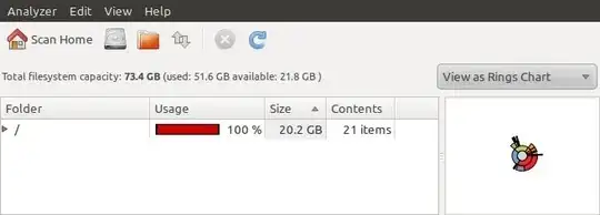

  2. Booted from the SSD. Emptied the trash, and the 16 GB from there are now free. The 30 GB are still missing.
    alt text

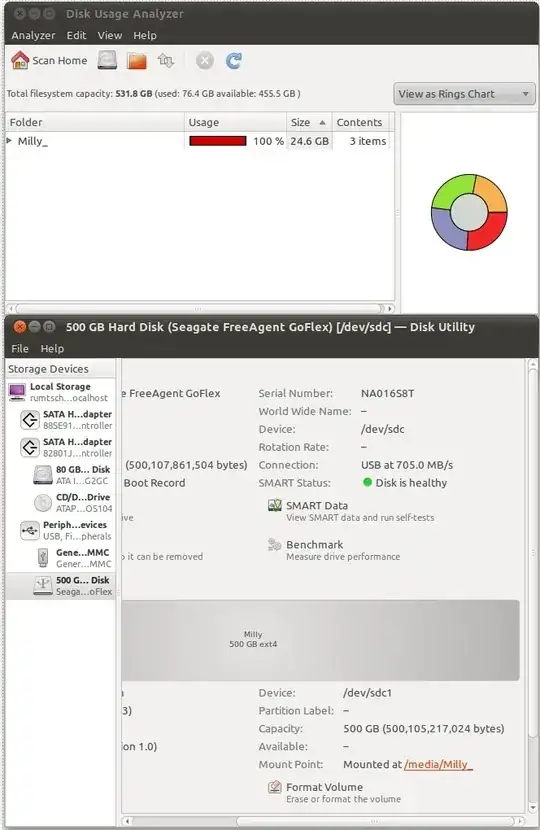

  4. Here it got really strange. I plugged in an external 500 GB HDD. Disk Usage Analyzer overreported the available space, then showed space missing (76 GB used, but only 24 in folders).
    alt text
Booted again from the LiveCD, started the Disk Usage Analyzer from it and got the same results as from the installed Ubuntu, within 1-2 GB.

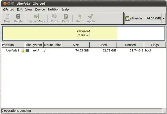

alt text

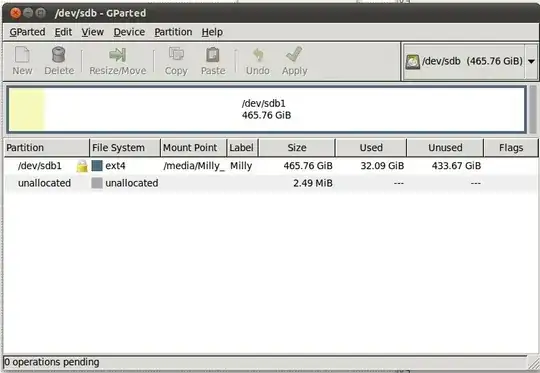

GParted also reports the correct size of the external HDD.
alt text

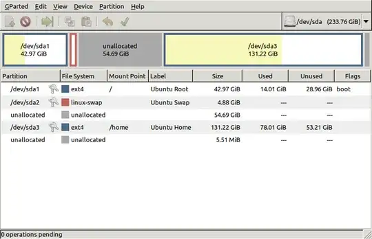

You can use the Disk Usage Analyzer to scan your directories and see where your space is going on the filesystem.
alt text
As for not being able to see 30GB of your disk, open up GParted and see how the space is allocated on the disk. It may be that your partition scheme isn't what you thought it was.
GParted
