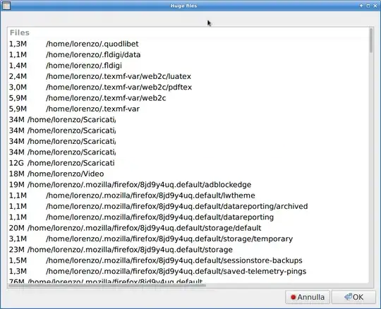

Don't worry, there is a quick and safe solution, just follow this mini-guide.
Open a bash terminal (CTRL+ALT+t), copy-paste the following command inside it and press ENTER:
du --human-readable --max-depth 5 --one-file-system ~ | grep ^[0-9\,\.]*[M\|G\|T].*$ | zenity --list --title="Huge files" --column=Files --text= --editable&
This is a simple script that shows a window with a list of all big files: click on an entry to select and copy the file path, find the file and then delete it. The script does NOT delete the files, do it manually after checking if you need to do a backup and remember to empty the trash.
Screen-shot for the one-line file listing script
NOTE: I've made the script 5 minutes ago and is very "spartan", please report any bug in the comments, thank you. ;-) NOTE: execute sudo apt-get install zenity if you get a "missing command" error.
