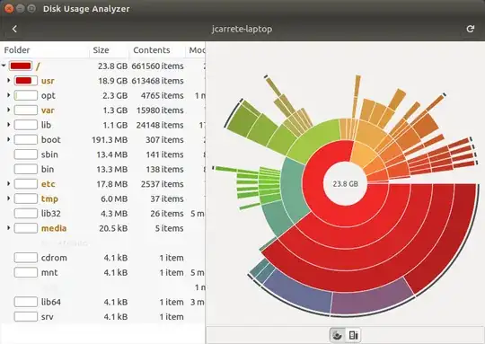

If you prefer to use a GUI-based tool, you can use the Disk Usage Analyzer. You can use this to dig through your hard drive and look for the largest folders.
In the example below, folder usr is the largest folder with 18.9GB, opt the second largest with 2.3GB, and so on. You can click on any of the sections on the diagram on the right or click on the tree structure on the left to expand.Sample Disk Usage Analyzer
Note: finding the largest files would be hard using this tool though as it only gives the combined size of folders. That is, a folder with 200 1MB files will seem larger than a folder with a single 100MB files. Therefore, if it is the largest files and not the largest folders that you are looking for, you are better off using the command line instructions given by @Rinzwind.
