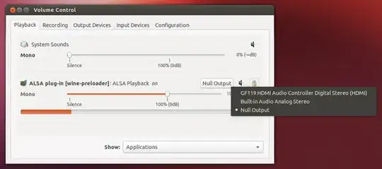

@Waschtl's answer is fantastic. @ixtmixilix asked about restoring regular audio after the recording is finished. Here's the easiest way I know of:
Install and run the pavucontrol GUI. You should see your audio-outputting application and it's volume meter under the Playback tab in there. There will be a button next to it showing that it's playing on Null Output. Click on that and change it to your ordinary audio output, Built-in Audio Analog Stereo in my case.
Here's a screenshot of what you're looking for:
screenshot
You can also use this approach to set up your recording in the future, after you've run the load-module command in @Waschtl's answer to create the sink.
