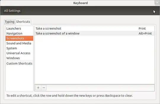

Update: I don't seem to have this key already mapped... enter image description here

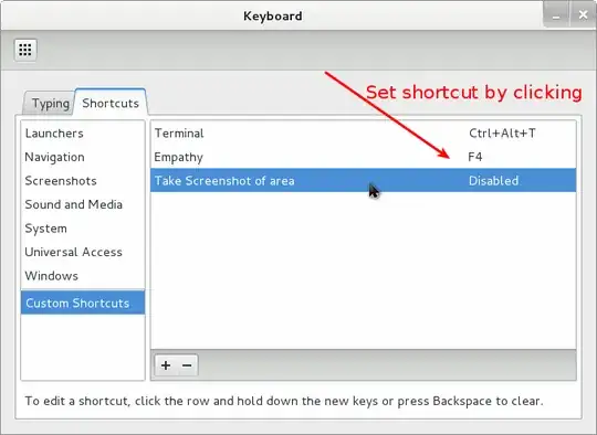

  1. Open System Settings -> Keyboard -> Shortcuts
  2. Select Custom Shortcuts(you can go to Screenshot-s too and it will work)
  3. Click +

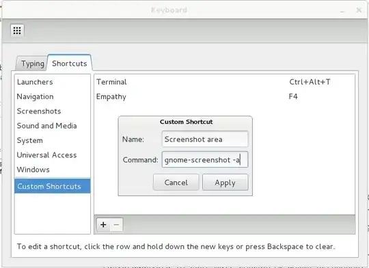

  4. Fill fields
    • Name to Take a screenshot of area
    • Command to gnome-screenshot -a or shutter -s(if u prefer shutter)
  5. Click OK
  6. Double-click on what you make and set shortcut Shift+PrtSc
— And that's all ... ;)
making command
settings shortcut

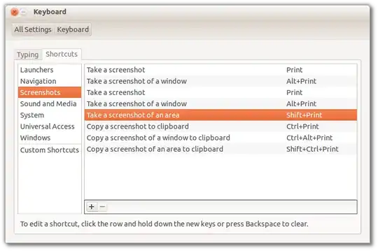

That shortcut is already built-in: Shift+PrtScr :)
The full-list of screenshot keyboard shortcuts is:

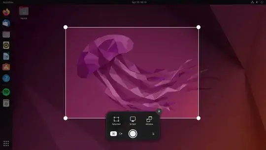

Gnome now includes a tool by default.
The previous Shift+Prt Scr seem to no longer work for me. Not sure if that is a regression.
But just pressing Prt Scr (Print screen) will bring up this UI, allowing you to snip:
Image courtesy omg! ubuntu! Ubuntu 22.04 LTS: Screenshot Tour
