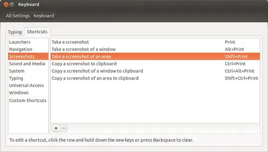

Here's a screenshot of my keyboard settings:
Keyboard settings
Any ideas?
