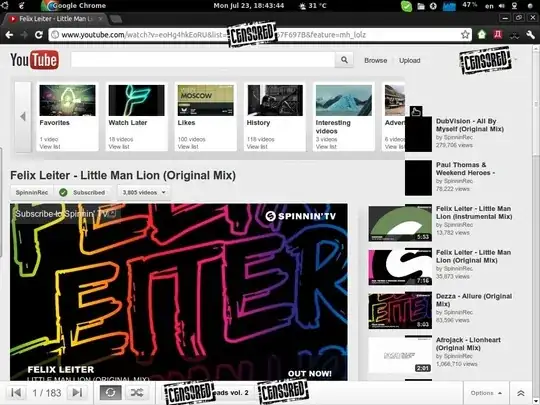

I'm former Chromium-browser user, but after not upgrading the PPA for 2 months, I switched to Google Chrome browser yesterday. Everything is okay, except some strange behavior on some pages and crashing after loading "chrome://" configuration pages. The best known website with strange behavior is youtube, there is a picture what I see: Youtube When I open user menu in top right corner, it crashes that way and even after closing the menu, some parts of menu stay display.
You may say it's Youtube problem, no, I have this problem at least on three other websites, here it is on Imgur: enter image description here The problem isn't for the whole side, sometimes it happens from the middle of the screen.
The interesting part is that it happens everytime in the same distance from the right border. When I check the DOM elements with the Developer tool, the overlay which shows element's position is rendered how it should be. What is more, if there is anchor after the crashed area, it works after clicking on it. Selecting text in crashed page is impossible.
I hope there is enough information to give me an advice, thanks in advance. :)

Ubuntu 12.04 | Gnome-shell 3.4.1 | ATI Radeon 4550 | Screen resolution 1024*768 | Chrome version 20.0.1132.57 (Official Build 145807)

It might be that the newer version of Chrome simply does not like your GPU. I have had issues similar to yours and have solved them by turning off the compositing and 3d acceleration features.
Type chrome://flags into the address bar and set the following items:
GPU compositing on all pages: Disabled (Three options in a drop-down.)
Disable accelerated 2D canvas: Enable (Click the link that says 'Enable', the box will turn white.)
Disable accelerated CSS animations: Enable (Like above, the item will turn white.)
Then click the button that shows up at the bottom of the page Relaunch now to restart chrome and test if this worked.

I had the same problem, and I learned this command from Google:
google-chrome  --blacklist-accelerated-compositing

I had the problem myself with some versions of the Intel GM965/GL960 driver. I suggest that you try updating your video drivers. You didn't mention if are using fglrx or not.
I have Ubuntu running in Virtualbox and at times Chrome's rendering issues would cause Ubuntu's rendering to crash forcing me to reboot the VM. My solution is as the same as Jove's above but I've added an alias to my ~/.bashrc file that helps me start chrome quickly via a terminal:
alias chrome="google-chrome --blacklist-accelerated-compositing &"
