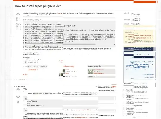

Since today I encounter weird graphical artifact when using Chromium ( makes it unusable).
It does not happen in Firefox or any other application.
Here is a screenshot :
chromium artifact
(Not visible in the screenshot but this also happens to the menu/tab bar. Not only in the page content.)
Out of curiosity I installed Chrome but the exact same thing happen.
I was wondering if it is a known problem with one recent update or if the problem come from my graphics card ?

Turn off the hardware acceleration in the settings of google chrome.It should solve the problem.
For me, this solved the problem.
