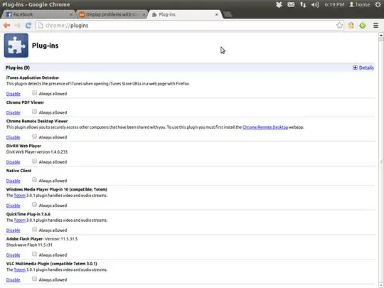

all suggested here, but it didn't help. List of all plugins installed - enter image description here Please help me in fixing this, any help would be appreciated.

Uninstalled AMD's additional display drivers and re-installed Chrome. Then disabled and enabled all plugins - no issues. Everything seems to be working right now, thanks a lot everyone.
