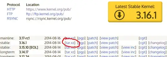

Download and extract the source code of the kernel you wish to build.
You can get upstream kernel source code at kernel.org. Version 3.16.1 (the latest stable kernel as of this writing) will be used here. So you may need to modify these commands if you're using a different version.
Kernel source code is currently provided in .tar.xz archives, so click the "tar.xz" link by whatever version you want:
screenshot from kernel.org, showing kernel source archives available for download
After cding to the directory where you downloaded the archive, you can extract it with tar:
tar xf linux-3.16.1.tar.xz
