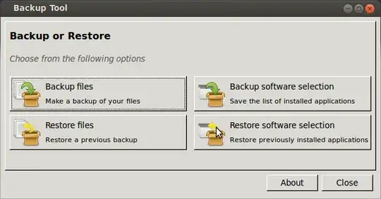

This is also possible through Gui way
sudo add-apt-repository ppa:webupd8team/mintbackup && sudo apt-get update
sudo apt-get install mintbackup
I guess image almost speaks itself, backup your selection, then in New installation restore it.
