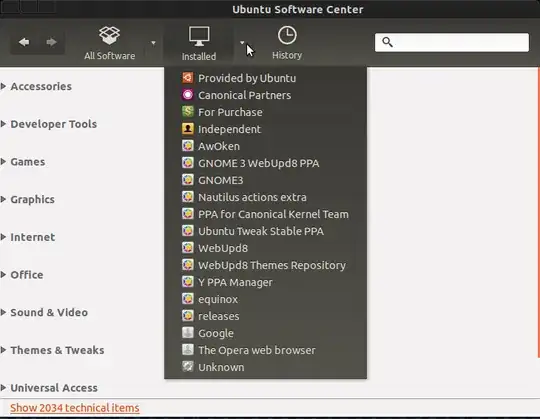

I want to be able to view packages that I have installed. I don't want it to be EVERY package on my computer but just the ones I got from ubuntu Software Center and sudo apt-get install.
From the Ubuntu Software Center :
Go to the Installed Tab:
You can also view all the software that you installed from the software Center by going to the History Tab:
