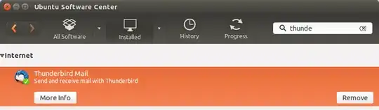

If you prefer a GUI, you can look for a program in the Ubuntu Software Center, which will tell you if it is installed or not, and also if it needs to be updated.

New applications to install or manage software are more consumer oriented, some of them are called stores, in Ubuntu it's currently called Software Center. You can browse all available software in Ubuntu, look which software is already installed, like Thunderbird, which software was updated and so on.
query in software center for thunderbird in the installed applications section
