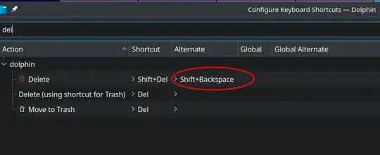

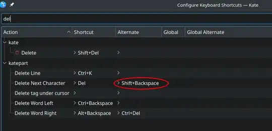

Very very old question, but just for reference:
  1. in later Linux/Ubuntu/Kubuntu: Fn+Backspace works as delete just like on OSX
In case Fn+Backspace is not working or is not convenient (Fn can be bottom left, backspace top right and two hands are needed) etc:
  1. some applications, like in Plasma, have their own editable shortcuts to delete next character (Kate text editor) or to delete files (Dolphin file manager):
