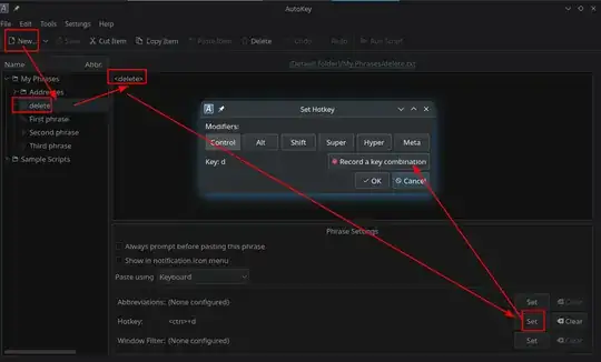

A good alternative to get the delete action (as well as others that I haven't tested) is to use AutoKey, described here, about the delete action:
