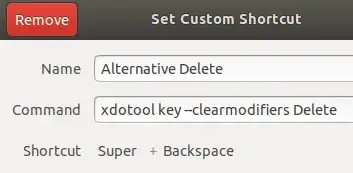

A command could emulate a specific keystroke. One way to do this is to create a custom shortcut to run xdotool (source) on Settings > Keyboard > Custom Shortcuts:

You can create a custom shortcut to do that Delete emulation, but it required a command.
