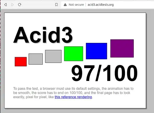

I searched and found Ubuntu official docs about WebKit.
From there I tried the test and I see the following results (anything less than 100 indicates a problem).
webkit test & error
The docs mention that you should have a 100, but it doesn't mention:
  1. What a 97 means
  2. Any extra docs to check and see what a less-than 100 means
  3. any indication of anything else
Does anyone know what that means or how to get more information?

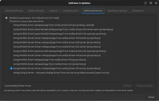

Updated NVidia Driver: Problem Solved
I updated to a newer version of the nvidia driver and the problem was resolved.
new nvidia driver
raddevus
