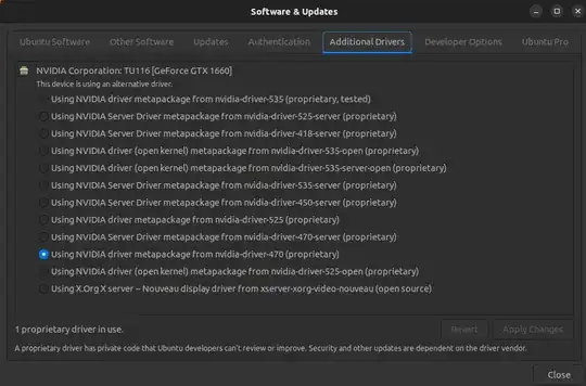

Here's the driver I'm currently running on my NVIDIA GeForce GTX 1660
I'm running Ubuntu 22.04.3 LTS & X11.
nvidia drivers & current settings
How can I know which one that is best?
Is it possible to switch to another one and try it out and easily switch back?
I want to try another one but I'm not sure if I'll lose all video display.

I went ahead and tried switching to another driver (which I'm guessing is newer). I had my fingers crossed.
Switched to the 535 driver shown:
switch to the nvidia 535 driver
It took a moment to install the drivers and then I saw no noticeable difference and things seems to be fine.
