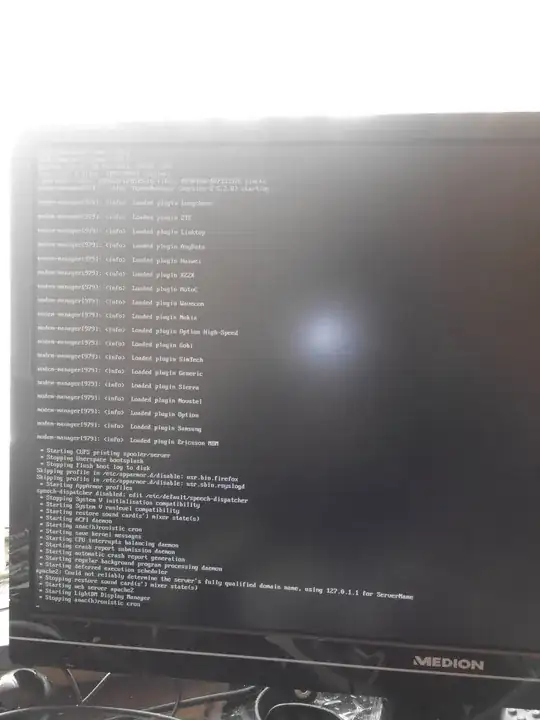

Where is my Ubuntu desktop? Its booting and going always default to terminal screen, if i press Ctrl+Alt+F7 still in terminal Ctrl+Alt+F1 still in terminal.
No GUI, how do I recover it?

There was posted in Ubuntu-forum this here to solve the problem after
"Stopping userspace bootsplash" appears like in your boot-log:
With the proprietary drivers installed they did the following:
Ctrl + Alt + F1 (To open up a terminal) and after login:
sudo apt-get clean
sudo apt-get autoclean
sudo apt-get autoremove
sudo dpkg-reconfigure -phigh -a
reboot
Entered Grub recovery mode and selected "repair damaged packages"
reboot
Hold Shift to get to grub menu hit E to enter temporary changes into grub place 'vmalloc=192MB' next to quiet splash
F10
And problem now solved ?!
They then made the change permanent by editing the /etc/default/grub to include:
GRUB_CMDLINE_LINUX_DEFAULT="quiet splash vmalloc=192MB"
Maybe this solves your problem ? Let me know !
