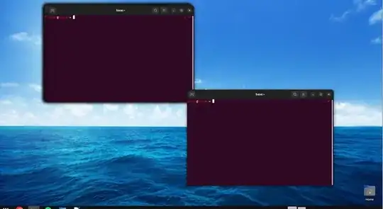

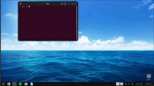

Short version: When I move a window, I see both the original window in its original position and the window in the new position. And perhaps a window or two in the path that the window was moved. E.g. here I started with a single terminal:
original single window
Then I moved the window:
Moved window
Only the bottom-right one is interactive...

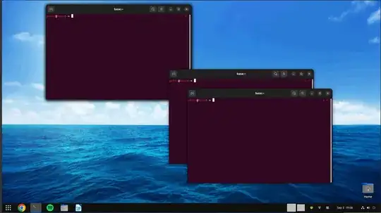

  • Connect a second time
    • Start x0vncserver -rfbport=5901 -PasswordFile=/home/peter/.vnc/passwd -display=:0 -fg on the server
    • Connect with xtigervncviewer to the client
    • See two or more windows!!! The original already-moved window is still there. The "old position artifact" remains (but looks a little different notice that top-right is actually two overlapping windows):
second vnc connection
So somehow the history of the original window position is stored on the server and survives an x11vnc/x0vncserver restart. Which leads me to believe that this really is a Gnome/Xorg/Compiz problem.
