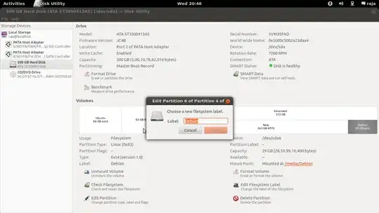

Open disk-utility from your Unity dash and click at your Harddisk .then click at the partition where you want a label then click Edit File System Label and give your New Label .enter image description here
