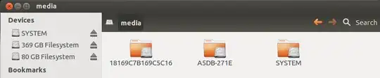

I've got two Windows drives next to the Ubuntu drive, they are called XXXGB Filesystem, where XXX is a size (80 and 329). How can I change their names to Windows and Data. I don't care, they are called strangely in /media folder, although it would be nice to know where can I change it too and how may I disable to show a system drive, that shouldn't be visible at all.
How it is now:

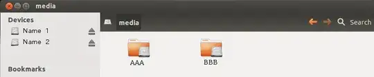

How it should look like:

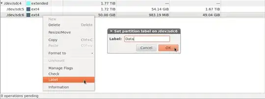

  • If you prefer GUI option than you can use Gparted.
    To install Gparted hit Alt+Ctrl+T to open terminal and run following command:
    sudo apt-get install gparted
    Once installed hit Alt+F2, type gparted and hit Enter or search for gparted in Unity Dash and run it from there.

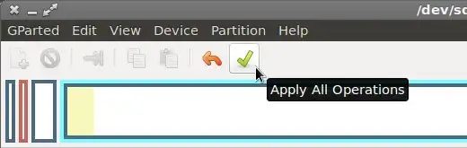

    Make sure the drive you want to label is unmounted, if it's mounted you can unmount it in Gparted, right click on the drive and select unmount.
    To label a drive right click on the drive you want to label and select Label, enter the desired label.
    Click on the apply button in toolbar. That's it!
