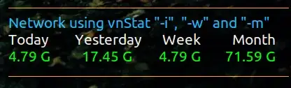

Conky example
Conky is a popular light-weight System Monitor used across many Linux distributions. You can vnStat bandwidth totals to your conky display like this:
Note when picture was taken Yesterday was Sunday which explains why the Weekly total is less.
The conky code to achieve this is:
${color orange}${voffset 2}${hr 1}
${color1}Network using vnStat "-i", "-w" and "-m"
${color}${goto 5}Today ${goto 100}Yesterday ${goto 225}Week ${goto 325}Month ${color green}
${execi 300 vnstat -i eth0 | grep "today" | awk '{print $8" "substr ($9, 1, 1)}'} ${goto 110}${execi 300 vnstat -i eth0 | grep "yesterday" | awk '{print $8" "substr ($9, 1, 1)}'} ${goto 220}${execi 300 vnstat -i eth0 -w | grep "current week" | awk '{print $9" "substr ($10, 1, 1)}'} ${goto 315}${execi 300 vnstat -i eth0 -m | grep "`date +"%b '%y"`" | awk '{print $9" "substr ($10, 1, 1)}'}
To save space on my narrow window, I used "G" instead of "GiB", "M" instead of "MiB", etc. If you have more screen real estate change substr ($10, 1, 1) to $10 and the same for $9.
You may have to change eth0 to wlan0 or eth1, etc. depending on your network name reported by ifconfig.

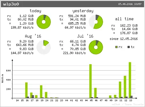

Just to expand rickys anwer:
With ifconfig | cut -c 1-8 | sort | uniq -u you can list the interfaces:
enp0s31f
lo
wlp3s0
For one interface, you can then visualize the traffic like this:
vnstati -vs -i wlp3s0 -o ~/summary.png
gives a nice summary:
  • rx is the received traffic
  • tx is the transferred traffic
