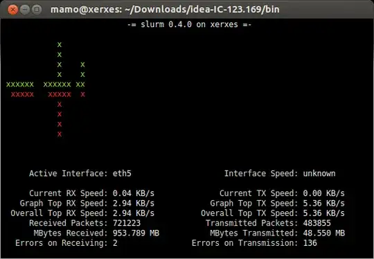

slurm
Has nice colored graphs
screenshot

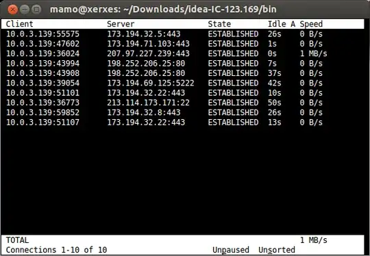

tcptrack
A favorite. Tells how much bandwidth is being used and also what protocol (service/port) and destination the transmission is taking place to. Very helpful when you want to know exactly what is using up your bandwidth
screenshot

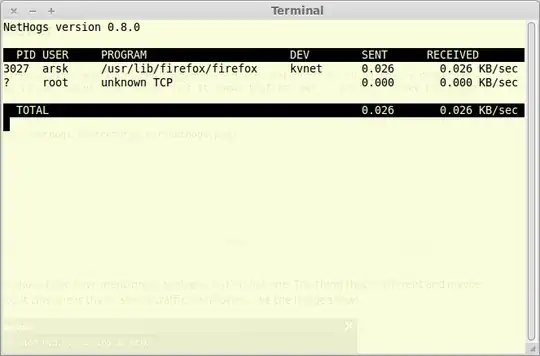

Nethogs
sudo apt install nethogs
sudo nethogs
The thing that's different and maybe is cooler about this one is that it shows traffic per process, like the image shows
screenshot

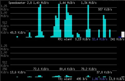

There is a nice tool called speedometer that displays a graph in the terminal using Unicode block characters, colors, and even adds labels to each peak in the graph.
$ sudo apt-get install speedometer
$ speedometer -l  -r wlan0 -t wlan0 -m $(( 1024 * 1024 * 3 / 2 ))
Screenshot after running the previous command
It has several options, can monitor multiple interfaces, can show multiple graphs in several rows or columns, and can even monitor the download speed of a single file (by watching the file size on disk).

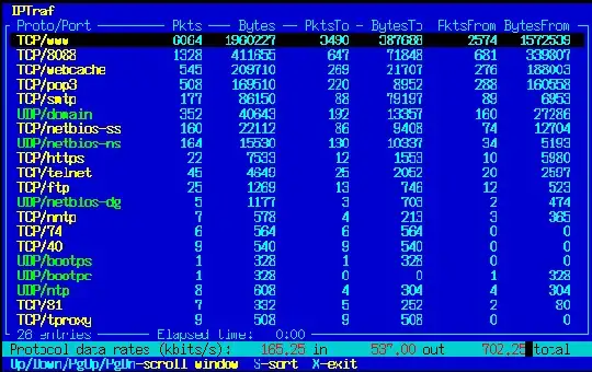

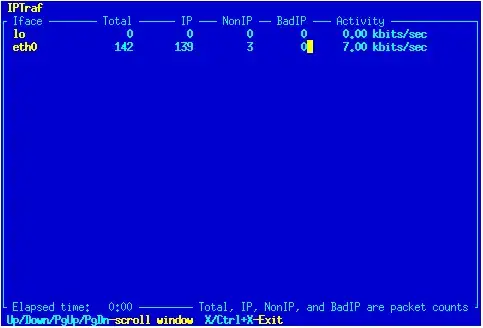

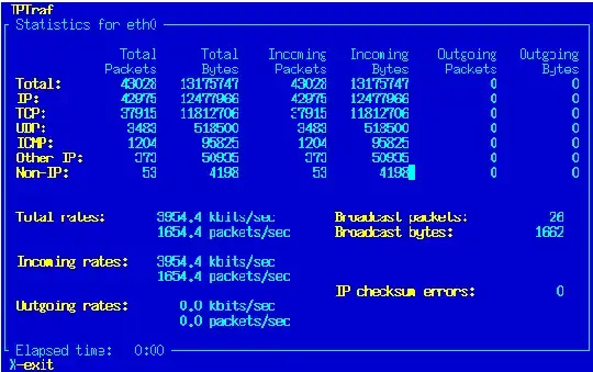

iptraf
IPTraf is a console-based network statistics utility for Linux. It gathers a variety of figures such as TCP connection packet and byte counts, interface statistics and activity indicators, TCP/UDP traffic breakdowns, and LAN station packet and byte counts.
Features
An IP traffic monitor that shows information on the IP traffic passing over your network. Includes TCP flag information, packet and byte counts, ICMP details, OSPF packet types. General and detailed interface statistics showing IP, TCP, UDP, ICMP, non-IP and other IP packet counts, IP checksum errors, interface activity, packet size counts. A TCP and UDP service monitor showing counts of incoming and outgoing packets for common TCP and UDP application ports A LAN statistics module that discovers active hosts and shows statistics showing the data activity on them TCP, UDP, and other protocol display filters, allowing you to view only traffic you're interested in. Logging Supports Ethernet, FDDI, ISDN, SLIP, PPP, and loopback interface types. Utilizes the built-in raw socket interface of the Linux kernel, allowing it to be used over a wide range of supported network cards. Full-screen, menu-driven operation.
Protocols Recognized
IP TCP UDP ICMP IGMP IGP IGRP OSPF ARP RARP
Non-IP packets will simply be indicated as "Non-IP" and, on Ethernet LAN's, will be supplied with the appropriate Ethernet addresses.
Supported Interfaces
Local loopback All Linux-supported Ethernet interfaces All Linux-supported FDDI interfaces SLIP Asynchronous PPP Synchronous PPP over ISDN ISDN with Raw IP encapsulation ISDN with Cisco HDLC encapsulation Parallel Line IP
Source http://iptraf.seul.org/about.html
Installation
With apt:
apt-get install iptraf
Or download the source:
http://iptraf.seul.org/download.html
Screenshots
Current Connections:
tcp connections
Current Ports:
Summary of all Interfaces:
Detailed per Interface:
Source http://iptraf.seul.org/shots.html

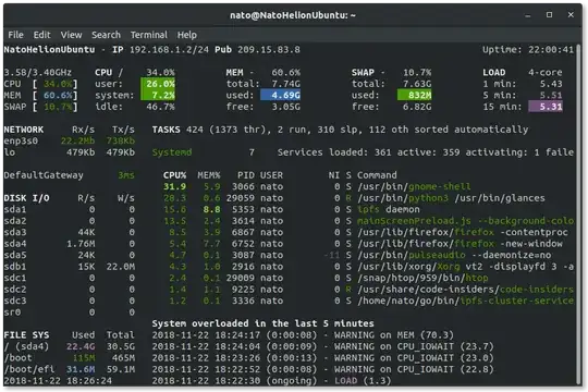

This is not specific to networking, but Glances can display network traffic of different interfaces.
Install it with one of those commands :
sudo snap install glances
sudo apt install glances

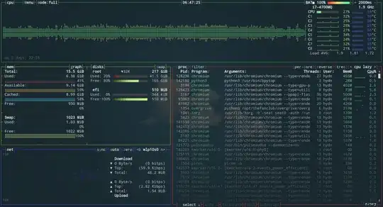

A powerful tool bpytop like a Swiss army:
Install:
sudo apt install bpytop
List interfaces:
ip -br -c a
Monitor all resources:
bpytop
Also, you can customize your output schema with numbers:
{1,2,3,4}

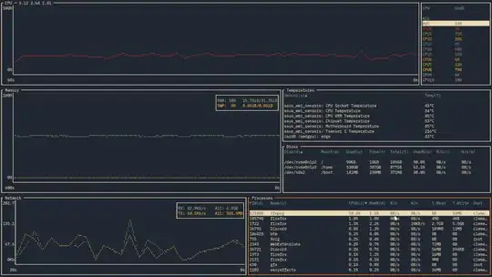

Another nice option written in Rust is bottom.
Install
A .deb file is provided on each stable release and nightly builds for x86, aarch64, and armv7. Some examples of installing it this way:
# x86-64
curl -LO https://github.com/ClementTsang/bottom/releases/download/0.10.2/bottom_0.10.2-1_amd64.deb
sudo dpkg -i bottom_0.10.2-1_amd64.deb
ARM64
curl -LO https://github.com/ClementTsang/bottom/releases/download/0.10.2/bottom_0.10.2-1_arm64.deb sudo dpkg -i bottom_0.10.2-1_arm64.deb
ARM
curl -LO https://github.com/ClementTsang/bottom/releases/download/0.10.2/bottom_0.10.2-1_armhf.deb sudo dpkg -i bottom_0.10.2-1_armhf.deb
musl-based
curl -LO https://github.com/ClementTsang/bottom/releases/download/0.10.2/bottom-musl_0.10.2-1_amd64.deb sudo dpkg -i bottom-musl_0.10.2-1_amd64.deb
Use
btm

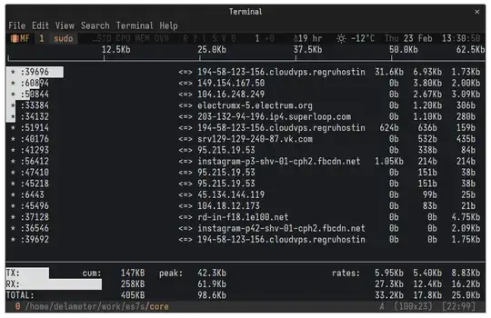

nettop is another option (not in the standard linux repos).
To build clone the repo:
git clone https://github.com/Emanem/nettop.git
Install the dependencies:
sudo apt-get install libncurses5-dev libncursesw5-dev build-essential libpcap-dev
And build the binary:
make
Run with:
sudo ./nettop
Btw, macos has a built-in utility called nettop which does the same thing but has more features.
