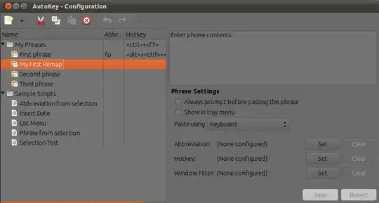

Press Ctrl+N or from File>Create..>New Phrase. Rename with whatever you like. enter image description here enter image description here

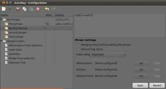

Enter keys In right panel(remove text Enter phrase contents) you want to get typed (in your case Shift + Left Arrow so will type <shift>+<left> )when you hit some key. full info for Special Keys like shift,arrow, etc. are described here. enter image description here

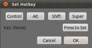

Click Set for Hotkey. You will be prompted to give HotKeys. If you want to make it run with single key (in your case 1) Don't click on any other button than Press to Set. enter image description here
Click Press to Set and hit a key you want to assign(in your case 1).

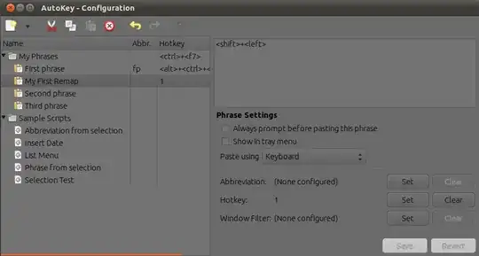

Click Save in bottom-right corner. enter image description here Now try by hitting 1 wherever you want.
