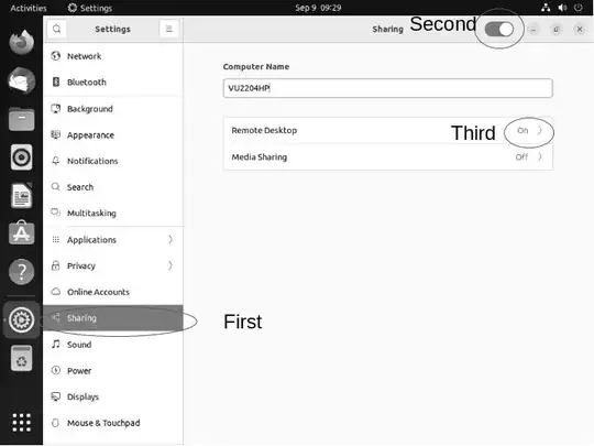

Go to the System Menu at the top right corner of the desktop and open Settings:
  1. Go to the Sharing tab on the left
  2. Toggle the button on at the top right corner
  3. Click on the Off > next to Remote Desktop

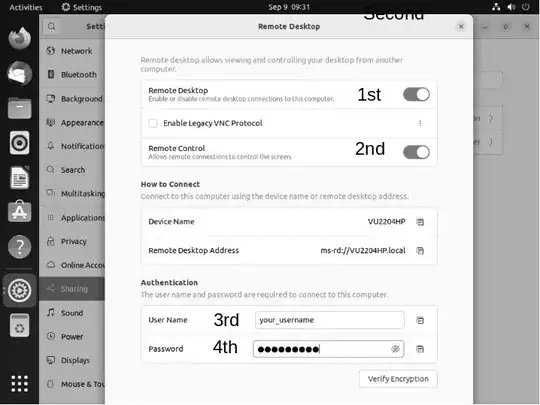

You will see the Remote connection configuration window:
  1. Turn the Remote Desktop button on
  2. Turn the Remote Control button on
  3. Set up your RDP username. This can be your login username or something more complicated and harder to guess
  4. Note down the password by clicking on the "eye" icon
