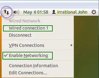

  3. Your Live CD session needs to be connected to the Internet for the remaining steps below to work. If your network is not connected, then try clicking on the connection in the Network Indicator's menu in the upper right-hand of the desktop. (See example below.)
    picture of networking indicator menu
