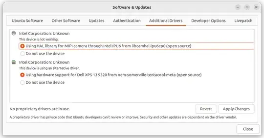

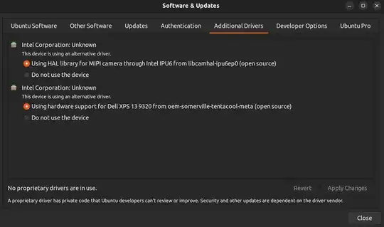

On my freshly installed Ubuntu 22.04 on my Dell XPS Plus 9320 the trick was to simply select Using HAL library for MIPI camera through Intel IPU6 from libcamhal-ipu6epO (open source) in the Additional Drivers tab in "Software & Updates", applying the changes and then rebooting the computer.

  4. switch to 'do not use the device' (on both options) and back for 'using ... for ... (open source) (apply changes both times and restart when needed) List item
  5. after a restart you should be able to sudo cheese -d "Intel MIPI Camera". now microsoft teams and discord should also work

I have a Dell xps plus with ubuntu 22.04, as Schmoove did I selected Using HAL library for MIPI camera through Intel IPU6 from libcamhal-ipu6epO and the webcam works with meet, teams but not with cheese. So I think the problem is in some settings of cheese.
Ozymandi4s
  • 51
In my case (new Dell XPS Plus 9320 with Lubuntu 22.04) Additional Drivers showed the possibility of using "Using HAL library for MIPI camera through Intel IPU6 from libcamhal-ipu6epO" but I could not select it. I tried manually through the sudo ubuntu-drivers list / sudo ubuntu-drivers install procedure but still did not work. At the end, I had simply to install the corresponding .deb package
