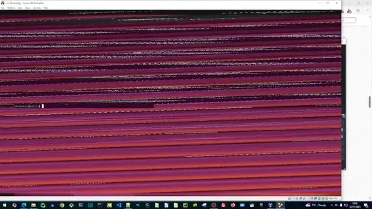

I seem to remember facing these issue since way before 22.0.4, but as I am currently loading a 22.0.4 VM I found myself here.
The issue, as always, is wayland, or Virtualbox. In any case Virtualbox has the issue (and fix I am using) documented here:
https://www.virtualbox.org/ticket/21955#comment:29
I did try the previously accepted answer, adding "i915.enable_dc=0 intel_idle.max_cstate=2", but to no avail. Corruption was this before that change:
orinary screen corruption

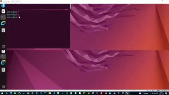

and this after updating /etc/default/grub:
screen corruption after updating grub cmdline
All of this is gone with X, i.e.:
Edit /etc/gdm3/custom.conf as root
Uncomment line: WaylandEnable=false
