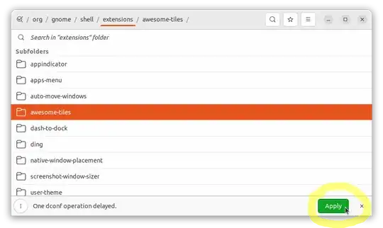

Navigate to /org/gnome/shell/extensions, right-click on the extension whose settings you'd like to reset ("awesome-tiles" in my case), and go to "Reset recursively", as shown below.
This resets all of this extension's settings!:
Next, to apply the change, you have to click the "Apply" button:
If you'd just like to reset some of the settings to default, do this instead:
Navigate all the way into the extension: /org/gnome/shell/extensions/awesome-tiles, right-click the setting (key) you'd like to reset, and click "Erase key":
Do this for any settings (keys) you'd like to reset to defaults. When done, click the green "Apply" button in the bottom-right corner, same as above.
