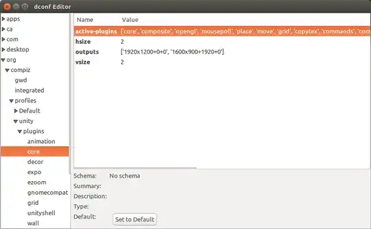

It simply means that the gconf settings have been migrated to the dconf database (See When to use gconf vs dconf?).
You'll now find the active-plugins list in the dconf-editor:
sudo apt-get install dconf-editor
You can edit this list and put both 'expo' and 'scale' plugins at the end to make them work the way you want.
