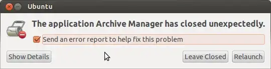

Whoopsie won't send your crash reports without your permission!
  • As Evan explains in his answer below, the actual transmission of crash data occurs only if you permit it via the graphical dialog (see below), or for a CLI server, explicitly run apport-cli.
    screenshot

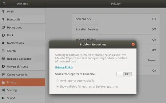

How do I disable it on my desktop?
GNOME Shell (Ubuntu 17.10+)
screenshot
