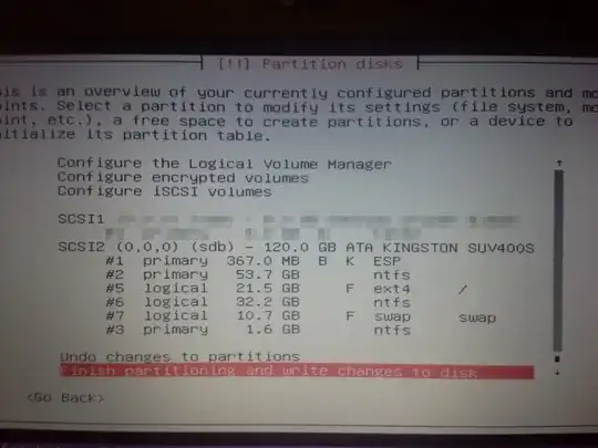

I wanted to install Ubuntu dual-boot on this machine along with Windows, so I booted up the mini.iso from USB thumbdrive (in EFI mode), which runs the text installer; originally it showed this state of partitions:
textinst-parts-01
I then tried to to set up partition 1 to be "Used as" EFI system partition, which resulted with this state being shown:
textinst-parts-02

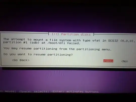

... however, the text installer would have none of it - and it failed with "The attempt to mount a file system with type vfat in SCSI2 (0,0,0), partition #1 (sdb) at /boot/efi failed.":
textinst-parts-03
So, yeah - the text installer does seem to make the assumption that the EFI partition is always vfat, and as in this case it is NTFS, the process there fails ...
So I cannot really tell, what I can do, to have Ubuntu installed on this system in dual boot configuration with Windows - without changing the EFI partition ...
