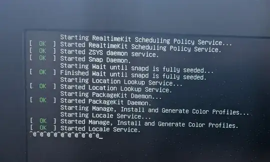

The third time was also a bit different.
A few seconds after freezing, it actually went down to a black terminal screen as during boot messages:
and then I was redirected to the login screen, as if I had been logged out.
I was able to login, my programs were closed, so I was effectively logged out.
