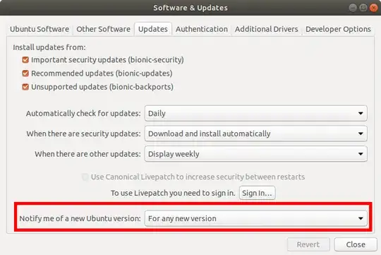

The solution to both of those is to go into:
software-properties-gtk
or access it through the Windows key dash where it is named:
Software & Updates
Then:
  • "Updates" tab
  • "Notify me of a new Ubuntu version" dropdown
  • "For any new version"
