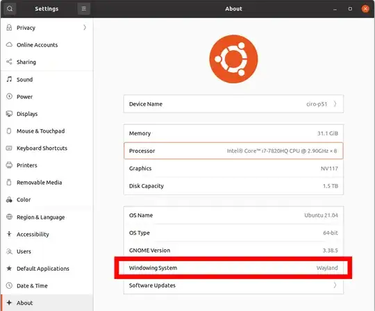

Settings > About > Windowing System
On Ubuntu 21.04, you can also see it from the Settings GUI (Win key, type Settings, select. Executable name: gnome-control-center), which is nice.
The default is Wayland on that system, 21.04 appears to be the first release where it was the default: https://www.omgubuntu.co.uk/2021/01/ubuntu-21-04-will-use-wayland-by-default
If I change to X11 as mentioned at: How do you switch from Wayland back to Xorg in Ubuntu 17.10? it says:
Windowing System: X11
instead.
As mentioned at: Ubuntu 21.04: how to enable Wayland? however, if Ubuntu detects that you don't have the hardware support, it fallbacks to X11 by default.
Also, the NVIDIA 460 driver doesn't support Wayland, and X11 becomes your only choice once you install it.
BTW, the 21.04 minimal ISO install (which has Wayland and no NVIDIA driver, which is proprietary and needs to be installed manually later) has a known bug that crashed my UI every other day: Ubuntu UI screen image freezes randomly during usage after fresh 21.04 install, suspecting Wayland or Nouveau making it unusable. The problem stopped when I installed the nvidia driver and used X11.
