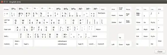

With the steps above, Keyboard Layout Chart shows the following picture:
All three Print Screen, Scroll Lock and Pause are recognized correctly. They are highlighted on the chart when corresponding keys are pressed on the keyboard. But the problem is that neither Print Screen, nor Pause (I use it as a replacement for Ctrl+Alt+L to lock screen) don't work. Sometimes cursor disappears when Print Screen is pressed, but the actual screenshot is not taken.
