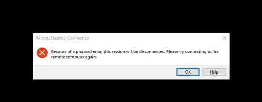

Although this is not an answer this may help someone following the answer from @Raffa above. I followed the answer from Raffa and I could not get it to work I kept getting this error:
this error

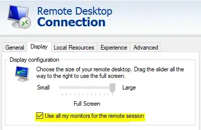

In the end the error for me was that I was trying to connect from a computer with multiple screens to a remote computer with one screen and "Use all my monitors" was checked in my RDP client see here:
see here
When I unchecked it it worked. Hope this helps someone.
