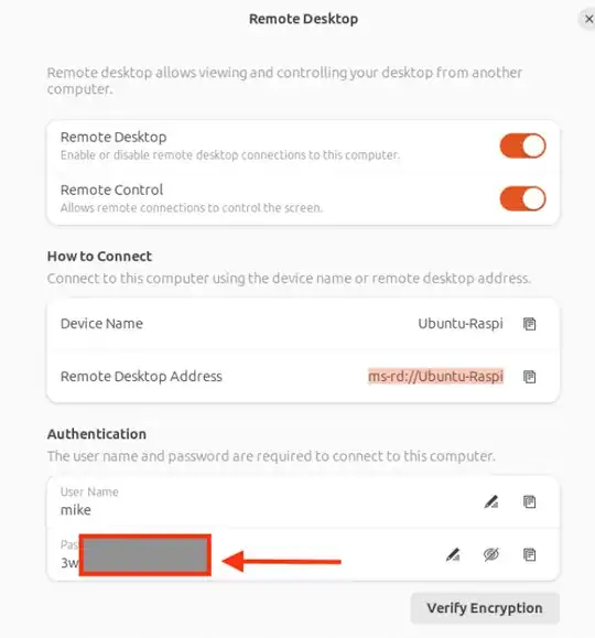

Don't know if this will solve everyone's problem but after doing all of the above without success, I found that using the password generated in the Ubuntu Sharing settings in MRD did the trick.
Screenshot

It's not recommended to run at the same time xRDP software and enable Ubuntu Sharing application because they are using the same port (i.e. 3389) which can create conflicts. It's either xRDP or Sharing Application..
Both applications have pro and cons....
  • Sharing Application allows you to perform RDP to your Ubuntu machine but a user needs to be logged on. If the session is locked, the session will ends
  • xRDP allows you to perform RDP to your Ubuntu machine but a same user can only be logged on either locally or remotely...not both at the same time. xRDP create a new session and you cannot take over an existing session.
If you want to use/test xRDP software solution, you should try the following
If xRDP software has been already installed on your Ubuntu
Step 1 - Disable the Sharing Application Feature Step 2 - Restart xrdp process issuing in a Terminal console
systemctl restart xrdp
Step 3 - Check that xrdp process is running accordingly issuing in a Terminal console
sudo systemctl status xrdp
Step 4 - Restart the machine Step 5 - Do not login locally on your Ubuntu machine Step 6 - Fire up your favourite rdp client Step 7 - If you see the xRDP login screen, provide your Ubuntu credentials Step 8 - You should see a Desktop interface loading...but might not be the one you are expecting
