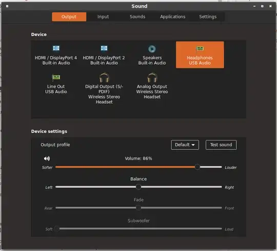

Now, when I open sound settings I can see a number of devices:
sound settings
When I select any Wireless Stereo Headset, HDMI 2 or Speakers Built-in appropriate device does make sound. But when I select USB Audio (Headset or Line Out) everything is quiet - even though the volume is set to 100%. I am running out of ideas what else could I check to fix this...
