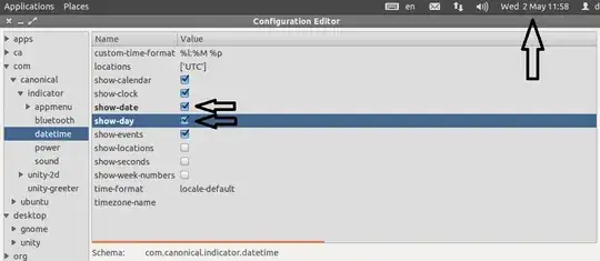

Using dconf-editor you can set various options to control the indicator-datetime applet
Navigate to com.canonical.indicator.datetime and tick the two checkboxes shown.
dconf-editor is part of the dconf-tools package which you can install from the Software Center or via a terminal command:
sudo apt-get install dconf-tools
If the date does not appear then check that you have the indicator-datetime package installed (logoff and logon after installing the package)
Install indicator-datetime
Later versions of Ubuntu sometimes do not show the path shown in the picture. You'll need to manually set one of the keys first before the path is shown in dconf-editor
For example:
gsettings set com.canonical.indicator.datetime show-clock true
gsettings set com.canonical.indicator.datetime show-day true
gsettings set com.canonical.indicator.datetime show-date true
