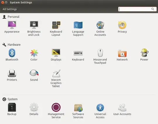

I recently installed ubuntu 12.10 and it seems as though my clock is missing. I also don't see any options for date/time in the system settings panel.
Am I missing something? Again this is with Unity.
