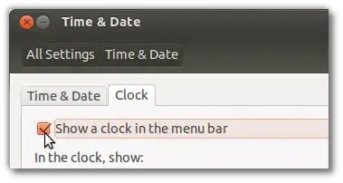

    5. Date/Time: Simply enable/disable from System Settings...Time & Date: enter image description here
