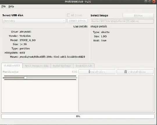

MultiBootUSB is a cross platform software written in Python which allows you to install multiple live Linux distros on a USB disk non-destructively and has an option to uninstall distros. From the MultiBootUSB Guide:
MultiBootUSB allows you to do the following
  • Install multiple live Linux distros and other operating systems to a USB disk and make it bootable without erasing existing data.
  • Uninstall installed OSs later.
  • Write ISO images directly to a USB disk (GUI for Linux dd command).
  • Boot ISO images and USB disks directly without rebooting your system using QEMU.
  • Boot USB on UEFI/EFI systems through GRUB2 bootloader support (limited support).
Adding a persistence file
  • Only distros based on Debian, Ubuntu and Fedora are supported.
  • Once you complete Step 2 (Choose an ISO), MultiBootUSB will detect the type of distro and a persistence size chooser slider will appear below the MultiBootUSB tab.
    The maximum size of the persistence storage space is also automatically calculated according to the USB disk filesystem.
  • Choose the desired persistence size by dragging the slider to the right and follow Step 3 (Click the ↓ Install distro button) as usual.
  • Once the Linux distro is installed successfully, you will find the additional persistence file under the distro install directory.
  • Reboot your system to choose your distro and a persistence menu will be added automatically to the menu entries.
